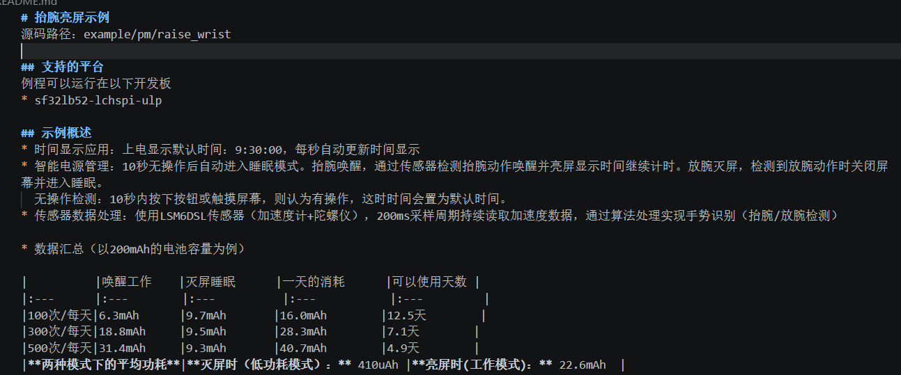

The Huangshan Pi uses the raise_wrist routine, directly burning and downloading. I simply measured the current through the Type-C port and found that when inserting the SD card, the current increases by about 20mA. How can this be eliminated? Looking at the schematic, PA_26 switches the power supply for the SD card and touch, and it is pulled low during sleep, but the increased current from the SD card remains.
