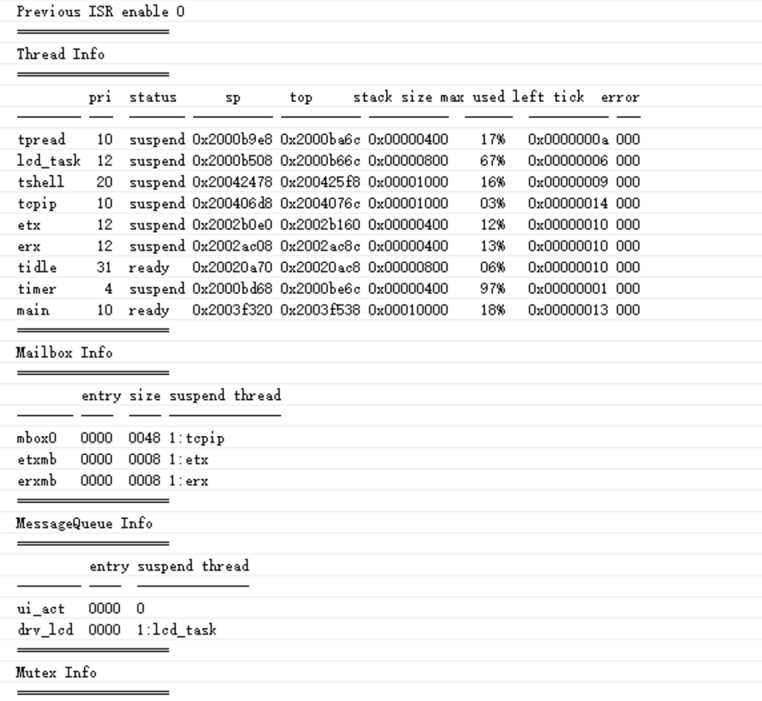

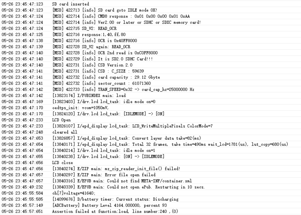

Can you send a log to take a look? Also, what modifications did you make?
Where are your book files stored?
The current state is that it cannot recognize the book. When entering the bookshelf and pressing back to return to the main page, it will directly freeze.
