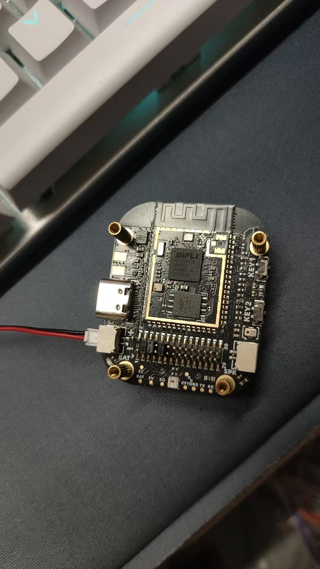

Also, why is it that when I plug into this port and apply 5V power, our development board completely doesn’t respond? The light doesn’t light up, and measuring the 5V and GND below also shows 0 (Note: here, the black wire I connected is indeed 5V, just the wire color is mismatched). But when I plug into the C port, everything works fine, but when I give it to the computer to run NSH, it always gets stuck right after running SF, before even reaching ABCD. That didn’t happen before.

@诺狞猫 But, but, the battery I first connected was 3.7 volts, and it didn’t respond. Then I switched to 5 volts, but it still wouldn’t light up. It’s really weird.
