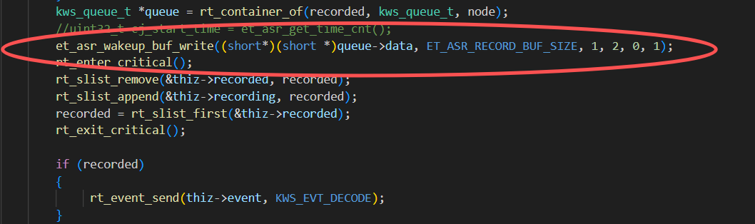

While studying and modifying the XiaoZhi program, I found that this function can recognize keywords when the websocket disconnects, and then reconnect to the XiaoZhi server. However, I can’t find out the specific function of this code.
I was researching XiaoZhi’s program and came across the UI section where
Hello, because the implementation of this function is blocked by the library, it cannot be viewed.
Yeah, is there any documentation or sample code introducing functions related to ASR?
No, this is provided by a third party. Only a demo is available, with limitations on usage次数. There is no detailed information for commercial use; for commercial purposes, you need to contact the third party.
Provided by Youjie Company
Alright, then I’ll have to figure it out by referring to Xiao Zhi’s sample code. Thanks!
