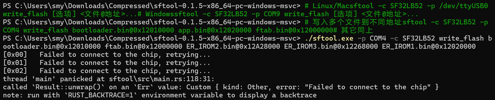

sftool flashing prompts failure
Check whether your port number is correct, and also verify if the corresponding files exist in that directory. You can refer to this document: sftool - SiFli-Wiki v1.0 Documentation.
They are all correct; what other issues could there be?
On Windows, try using the .\\ prefix before sftool.exe.
Before burning, you can reset the board or enter boot mode to ensure the board enters the burning mode.
