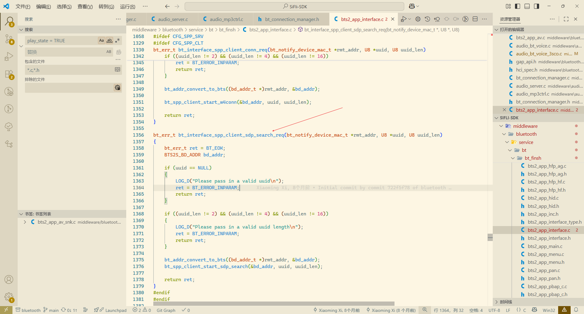

image You need to call this interface first to perform an SDP query, and then call the connection interface.
