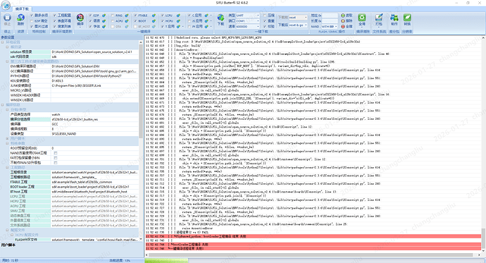

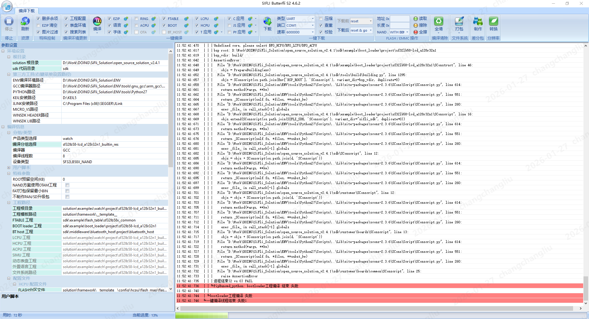

Bootloader project compilation failed
Could someone please explain the reason for this compilation failure?

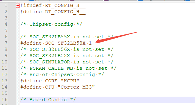

Has lcpu ftab been compiled previously? Then, check whether the rtconfig.h file in the following directory contains this macro:
open_source_solution_v2.4.1\sdk\example\boot_loader\project\sf32lb58-lcd_a128r32n1
image has this macro
