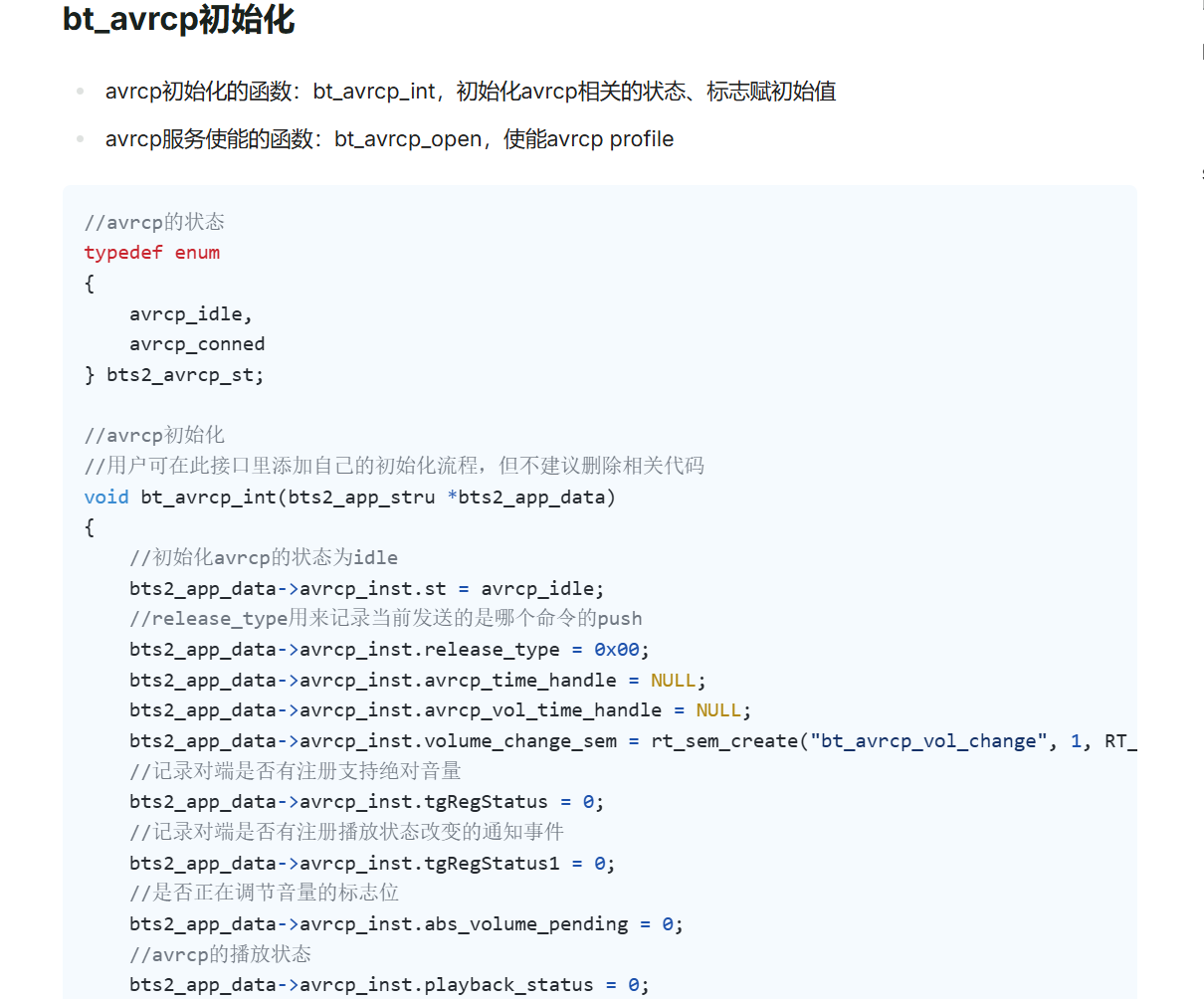

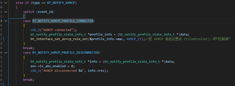

In the bt\music_sink example, there is a function to set the AVRCP role; can I directly call AVRCP-related functions to control the TG end without performing initialization?
Currently tested and found that relevant API functions can be directly called to control the Telegram client.
