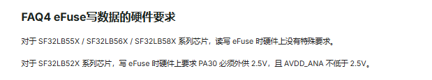

eFuse Usage - SiFli Solution Documents
If you are using the 52 series chip, you need to pull up PA30 to 2.5V.

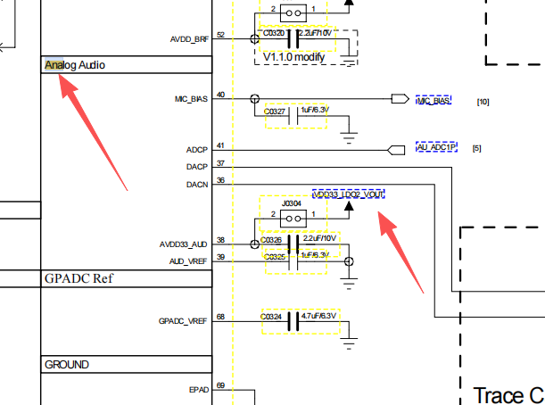

What is AVDD_ANA

How do you measure the voltage here?
The default design uses an internal LDO for power supply, and this LDO outputs 3.3V.
How to confirm? Simply measure the voltage near the IO power supply with a multimeter.
