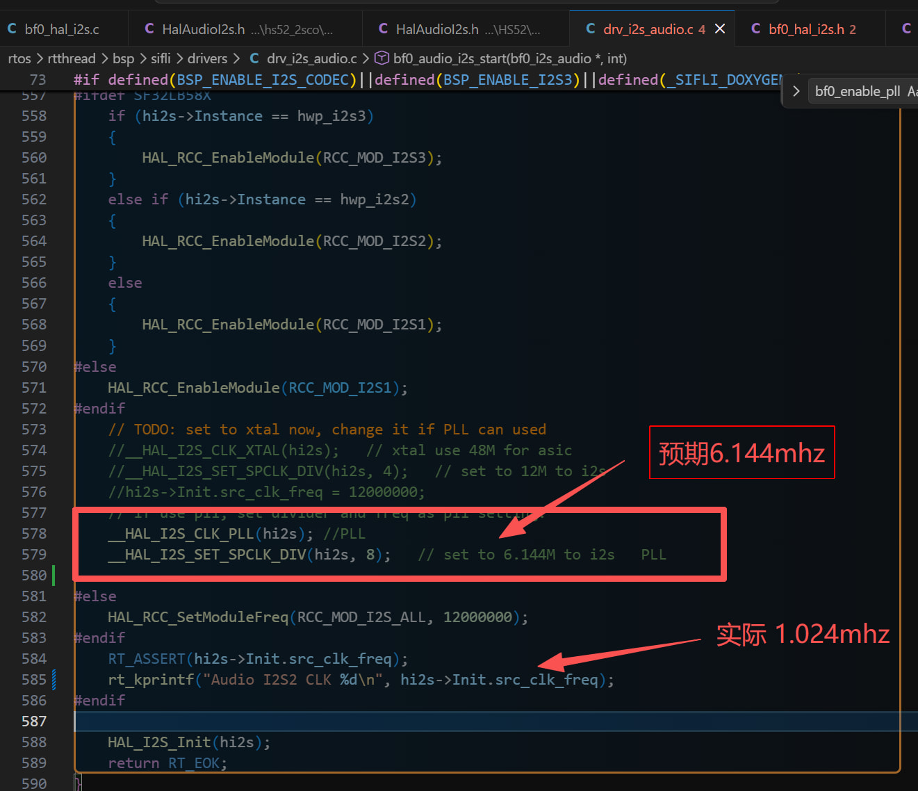

Is it normal that a DAC chip cannot be used due to what appears to be a specific clock limitation in SF32LB52? In drv_i2s_audio.c, the clock divider is set to 8, and the expected I2S clock is noted as 6.144 MHz, but the printed actual frequency is only 1.024 MHz. Is this correct?
If the final effective frequency is 1.024 MHz, subsequent use of the txrx_clk_div parameter seems to cause issues.
The src_clk_freq in the code is only assigned but not used anywhere.
For 55x, \__HAL_I2S_CLK_XTAL() is called, which uses 48M.
Others call \__HAL_I2S_CLK_PLL(), which uses 49.152M.
To change the frequency, refer to https://gitee.com/SiFli/sifli-sdk/blob/main/rtos/rtthread/bsp/sifli/drivers/drv_i2s_audio.c
and check I2S_USE_DOUBLE_MCLK, where I2S_USE_DOUBLE_MCLK is defined as 1.

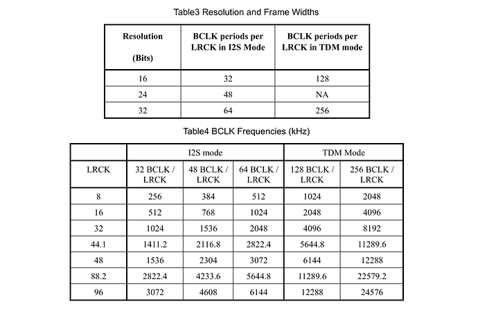

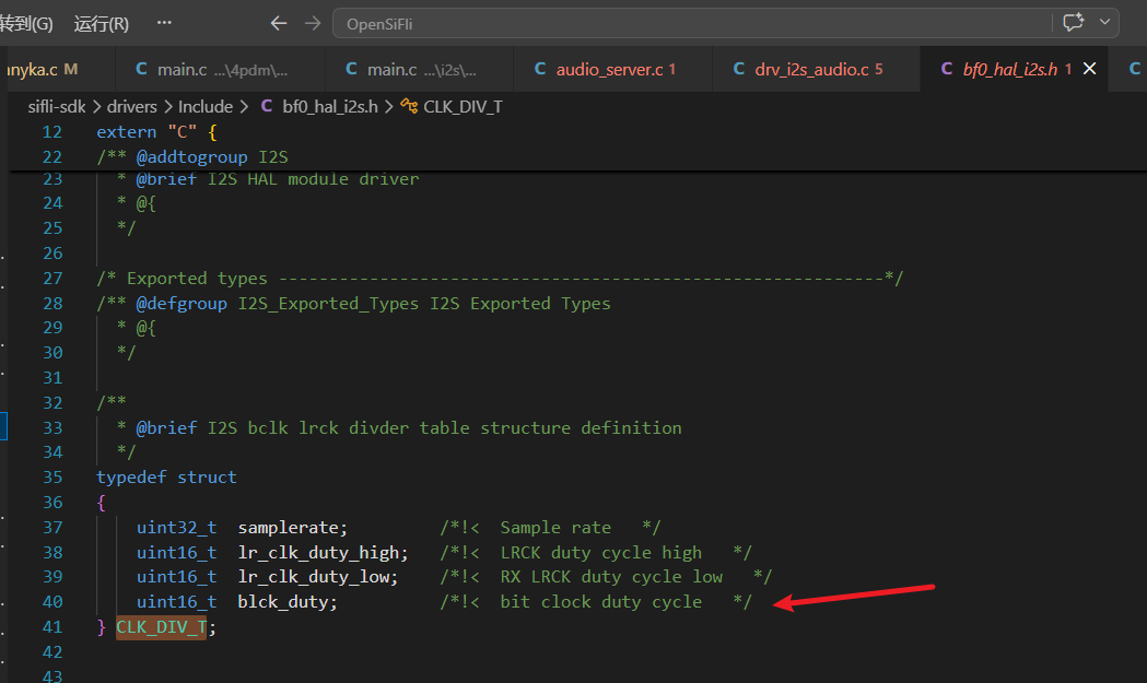

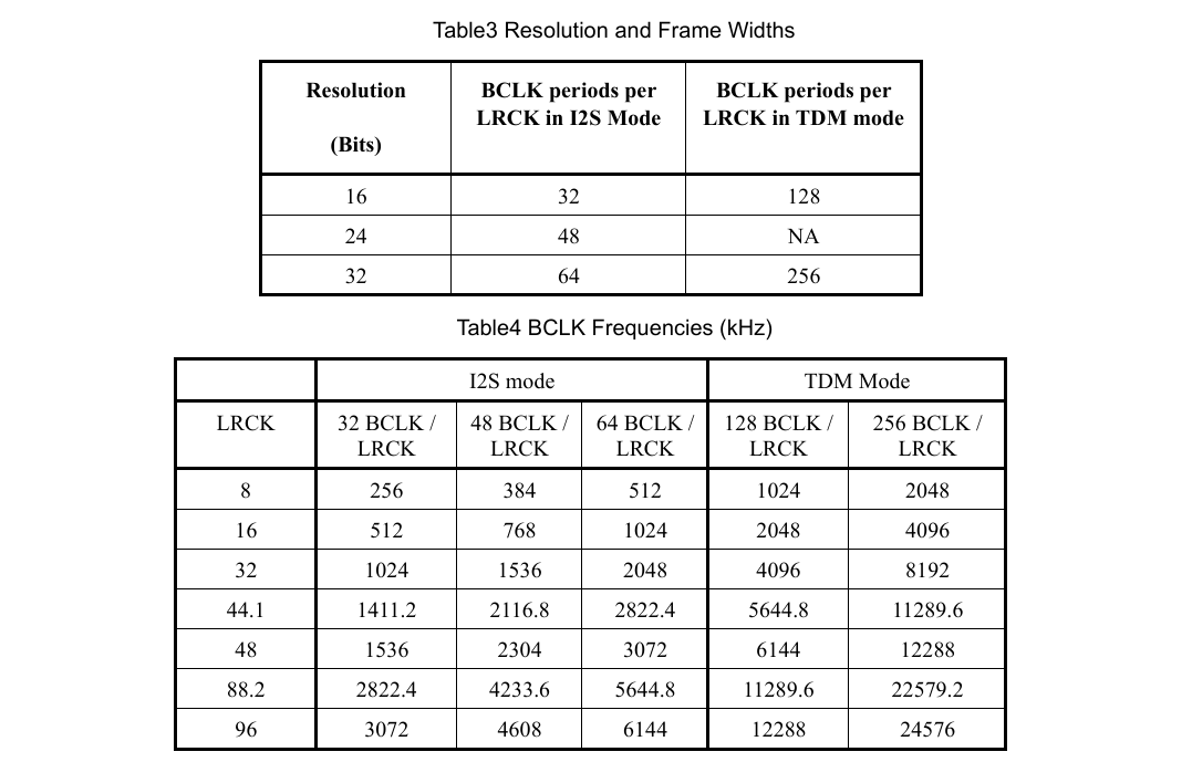

How can I limit the BCLK under a fixed audio format? Is it mainly by modifying the txrx_clk_div parameter?
As mentioned above, just take the latest drv_i2s_audio.c code and set I2S_USE_DOUBLE_MCLK to 1. The fourth parameter in CLK_DIV_T is used to adjust the bclk.
