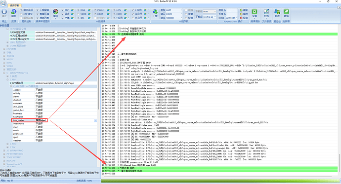

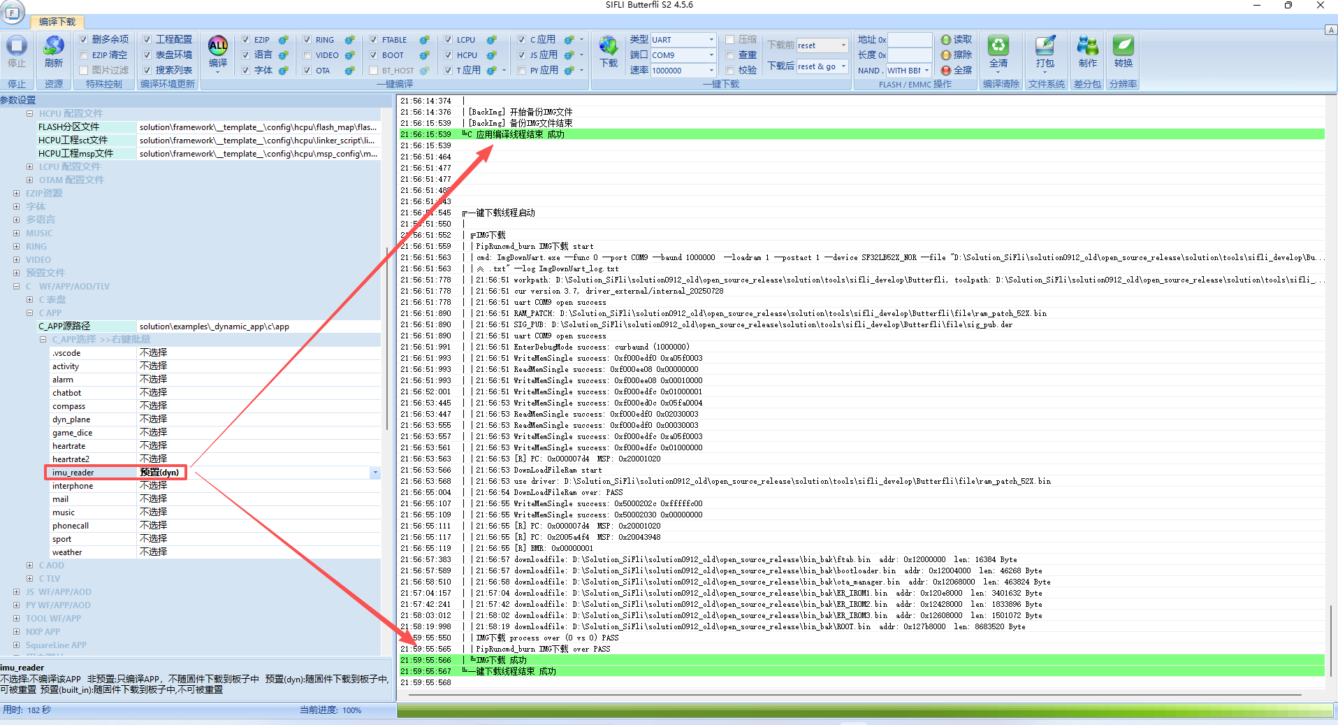

External app compiled and downloaded successfully in solution, but not present on the watch

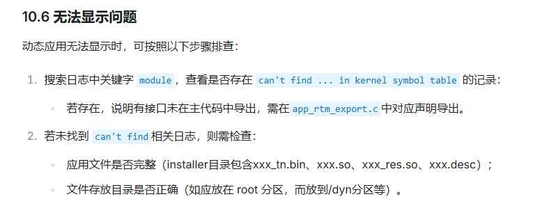

You can first refer to this guide to troubleshoot the issue.
Dynamic Application Guide - SiFli Solution Documents
