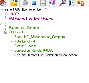

Now I can connect to the computer, but after about 10 seconds of connection, it automatically disconnects.
Could you please provide the corresponding HCI log?
Hello, the log is as follows. Connecting to the phone is fine, but the computer automatically disconnects after a while.
log.zip (41.3 KB)
The code is as follows. It is modified from example/bt/hf. I added a voice link, and for microphone capture I use the official functions, not written by myself.
@chaotaoyang @zhenpeng
The computer side actively disconnected. Compared with the PC connecting to the headset, the PC connected A2DP + HFP, not just HFP alone.
We suggest you test with a project that supports A2DP + HFP.
