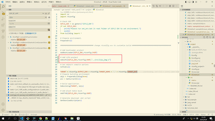

Check your project’s SConstruct file to see if this is present. If not, you can add it.
感谢兄弟,真的一加上就成功了,感激不尽,虽然不知道为啥,难道这个文件Finsh不能配置吗
This added component is the Bluetooth LCPU project, which is only included by default in projects using Bluetooth. If you are porting Bluetooth to other projects, you need to add this component in order to use Bluetooth.
