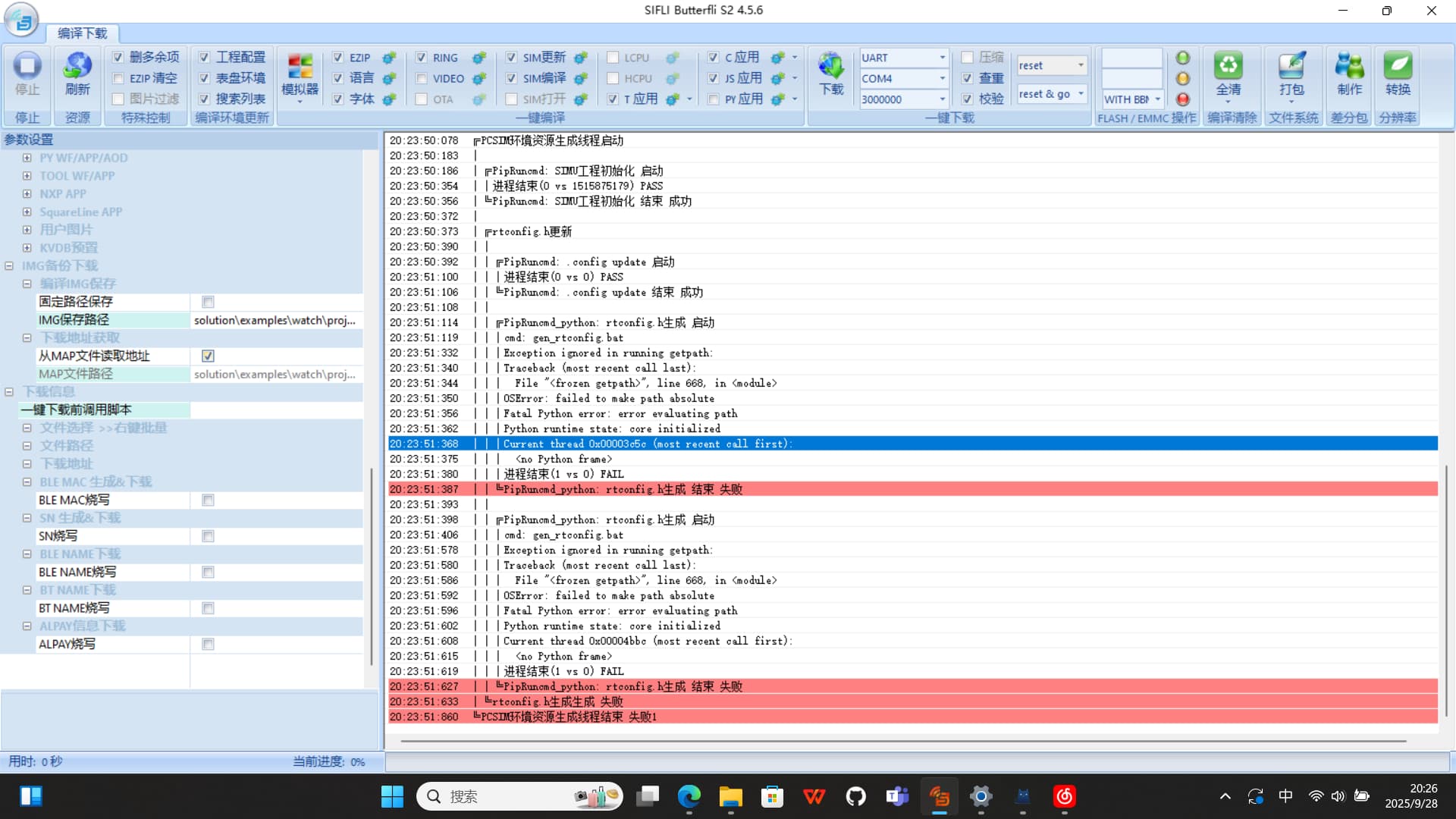

[PipRuncmd_python: rtconfig.h generation failed] Asking if anyone knows how to fix this error causing butterfli compilation to fail
The root cause of this issue is that there might be a problem with the kconfig files, causing menuconfig to fail generating the corresponding rtconfig.h file from the configuration. You can right-click in the simulator directory → ConEmu Here → enter the command “menuconfig” in the command line, and follow the prompts to identify which specific kconfig file is abnormal. Then manually correct it according to the error message.
