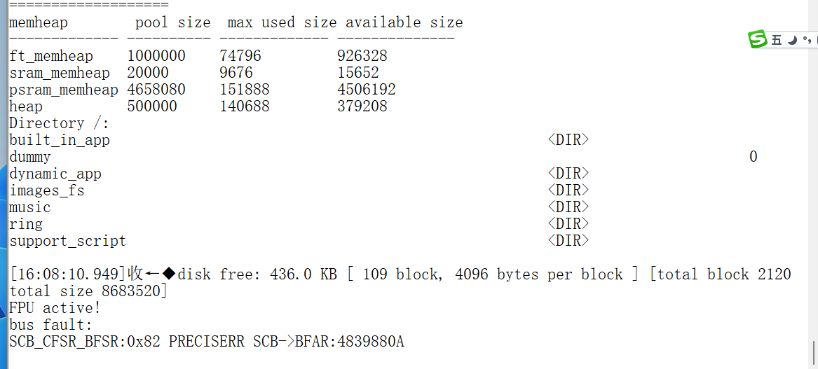

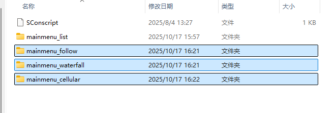

The original official example includes these folders. However, since I wanted a list-style main menu instead of a grid layout, I deleted these folders. After compiling and flashing to the Huangshan Pi, I found that the system crashes every time I scroll down to the 8th icon. Could you please help identify where the problem might be?

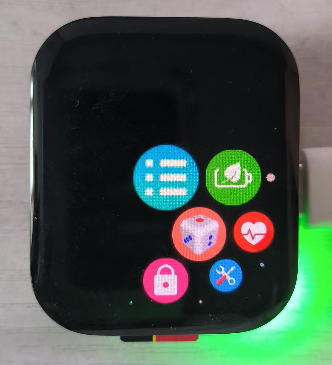

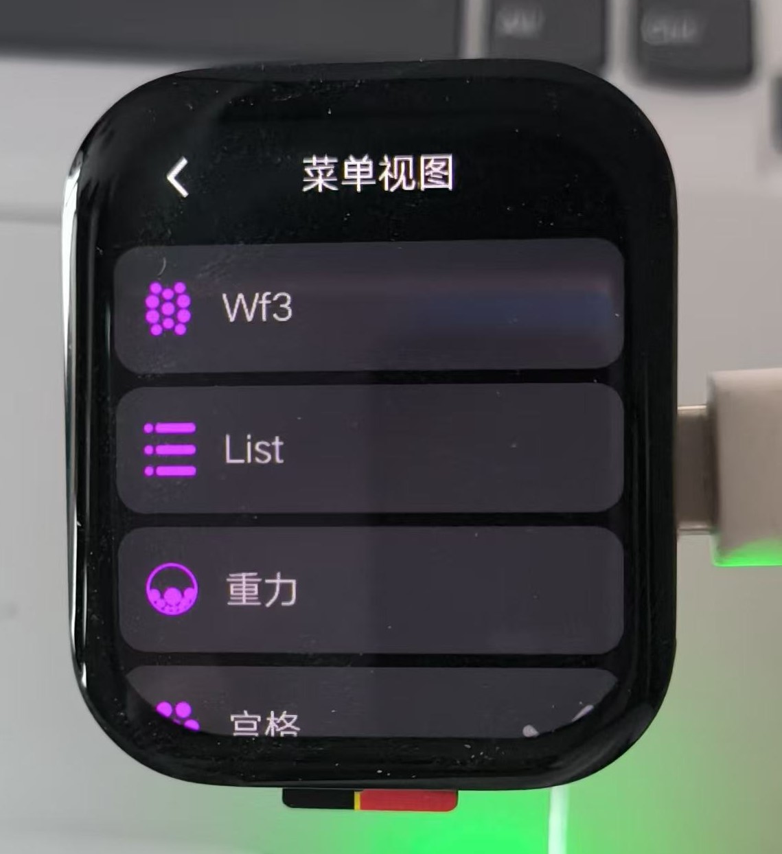

To use the list menu, click on the menu below and select List from it. There’s no need to delete other folders.
