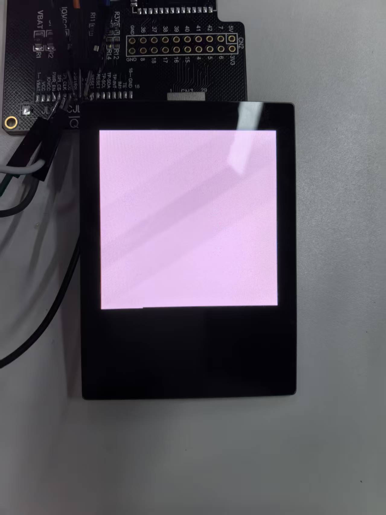

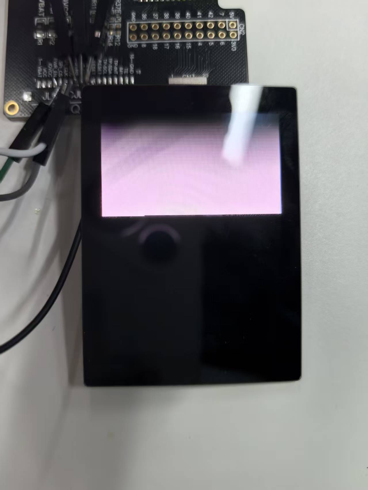

I used the SF32LB52-DevKit-LCD development board to connect an RM690B0 display. I checked and found almost no difference between RM690B0 and RM690C0, so I modified the RM690C0 driver to create a driver for RM690B0. The screen resolution is 600×450, using a QSPI interface. I ran the rt_driver demo, but found that the display is incomplete and only shows black and white colors, without any other colors.

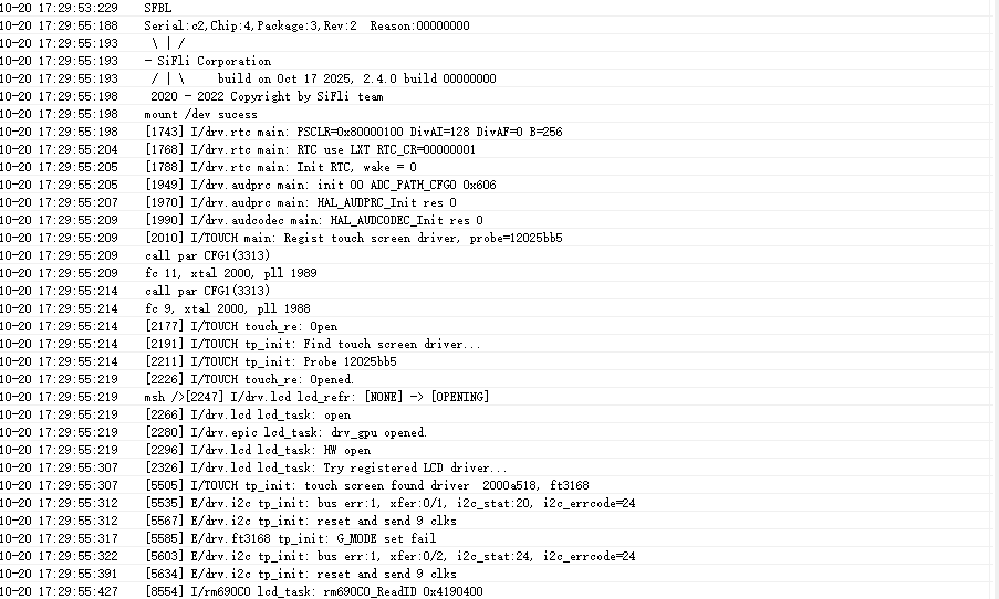

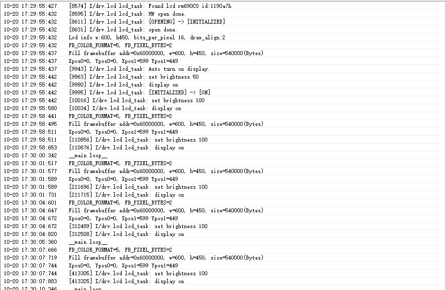

I have already modified the screen resolution and color depth settings in the driver. Below is the content printed in my log:
Your screen probably requires data in RGB888 format, but your driver layer is configured to make the LCDC output RGB565 data.
static const LCDC_InitTypeDef lcdc_int_cfg_qadspi =
    .lcd_itf = QAD_SPI_ITF,
    .freq = QAD_SPI_ITF_FREQ,
    .color_mode = LCDC_PIXEL_FORMAT_RGB565,  <<<<<<< LCDC output color format
