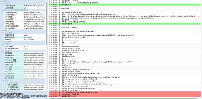

Butterfli编译报错,黄山派的LCPU工程报错L6016
keil版本为v5.32
23:15:01:094 │││LINK build\bf0_ap.axf
23:15:01:199 │││Fatal error: L6016U: Symbol table missing/corrupt in object/library BF0_HAL.lib.
23:15:01:202 │││Not enough information to produce a SYMDEFs file.
23:15:01:203 │││Not enough information to list image symbols.
23:15:01:206 │││Not enough information to list load addresses in the image map.
23:15:01:207 │││Finished: 3 information, 0 warning, 0 error and 1 fatal error messages.
23:15:01:351 │││scons: *** [build\bf0_ap.axf] Error 1
23:15:01:374 │││scons: building terminated because of errors.
23:15:01:518 │││进程结束(2 vs 0) FAIL
没有看见有c文件参与编译,可以先清除一下再编译试试。
清除编译也不行,我重新解压了一份在其他位置就可以了,应该是文件路径有问题
