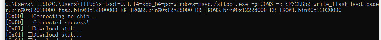

Encountered an error saying the specified file was not found when using the plugin version of Xiaotangyuan to burn the program.
After compiling and downloading, the following error occurs. How can I check and analyze the cause?
[0x00] Connected success! [0x01] Download stub success!
Failed to parse file bootloader.bin@0x12010000: The system cannot find the specified file. (os error 2)
Based on the error message, I tried using different versions of the Xiao Tangyuan example programs for downloading, but all resulted in errors.
I then tried changing the downloader, purchasing the official CH340X to perform the download, but the problem still couldn’t be resolved.
Help needed!
This is caused by an incorrect bootloader file path. By default, the terminal’s path is relative to the input path; please verify the path.
image Thanks for the reply,大佬. The path shouldn’t be an issue—I directly copied and pasted the file and sftool.exe addresses; they’re in the same folder. Every time it shows “stub succeeded,” then it fails to find the bootloader, just like in the求助 post’s photo. I’m even starting to suspect a hardware issue now. :broken_heart:

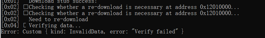

Hello expert, I solved the issue of not being able to download the bootloader by adjusting the absolute path, but now I’m encountering an error. Could you please help me take a look?
How about retrying this once more? Does it happen every time without fail?
It’s been the same after three attempts..
This seems like it might be a hardware issue. Could you please add my contact information?
