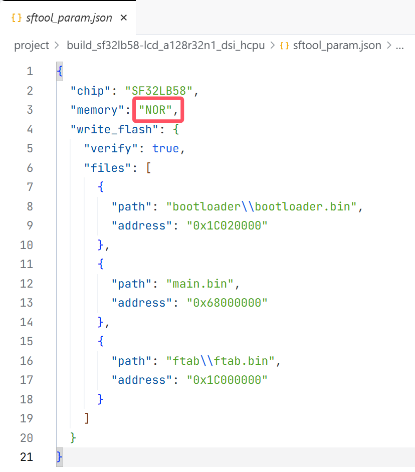

The sftool_param.json configuration for sf32lb58-lcd_a128r32n1 seems to be incorrect
Actually NAND, but NOR is filled in here

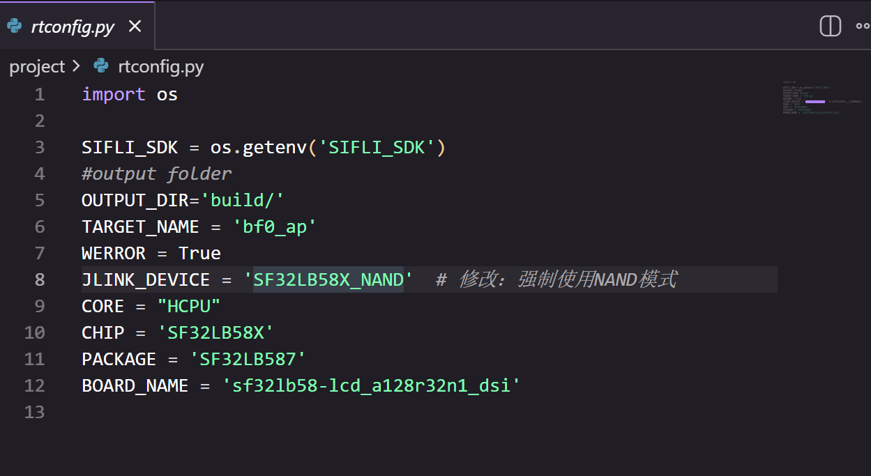

Need to modify this part under the project directory
