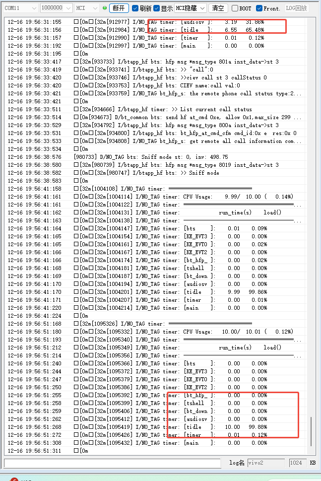

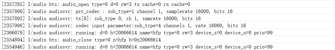

Capture a log to check. Generally, audio should be disabled; if no changes were made, this issue shouldn’t occur. If there is an audio_open type=0, as long as there’s a corresponding audio_close type=0 afterward, then it’s properly closed. Also, run the sys_info command before and after to check whether the system has throttled frequency.
image The CPU appears to be normal
8eacc5550706f9039a8bf534e08a3041 audio_open type=0 and audio_close type=0 are available.

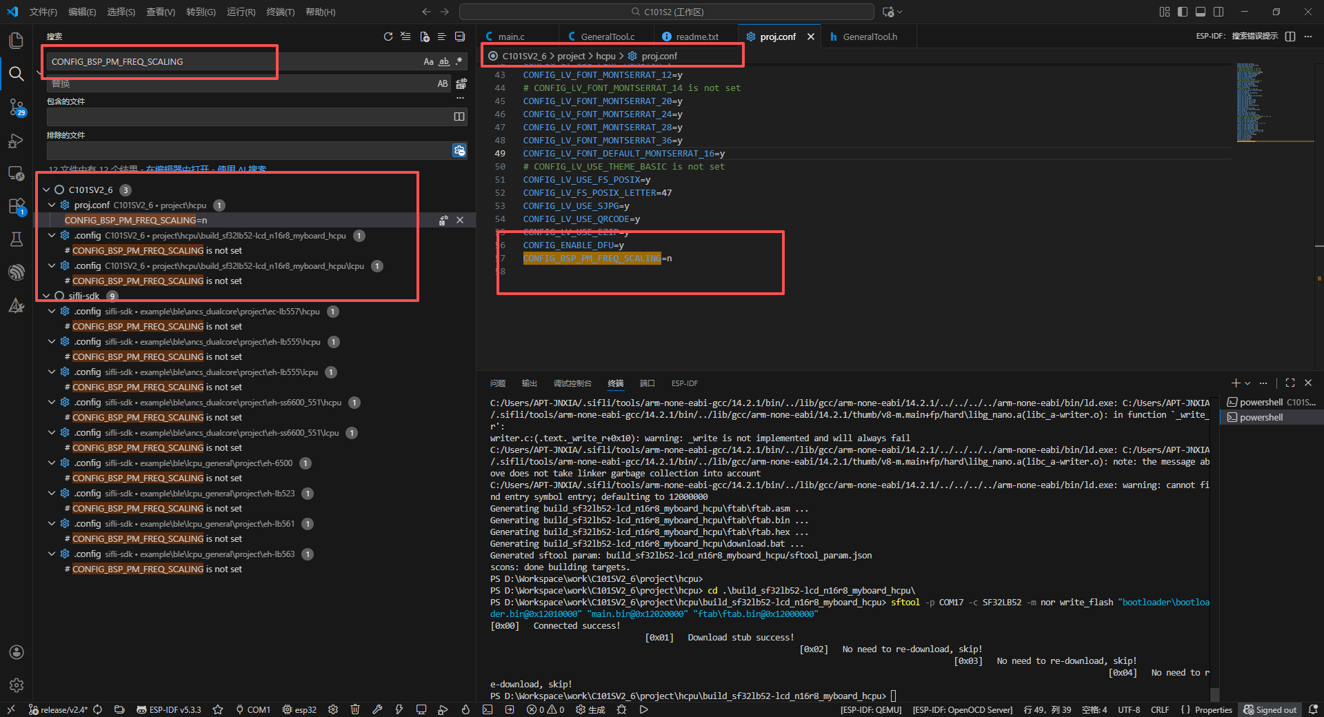

I added CONFIG_BSP_PM_FREQ_SCALING=n, but there’s still lag. Looking at the build output, it seems this setting isn’t being applied. Could you please check whether I’ve added it in the correct location?
Check the .config or rtconfigh file under the build_sf32lb_52xxxxx directory. If BSP_PM_FREQ_SCALING is not present, frequency scaling is not enabled. If frequency scaling is confirmed to be disabled, then check the CPU usage to see if any process is consuming high CPU.

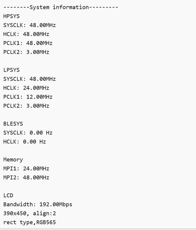

It’s the sysinfo command; run help to see what commands are available.

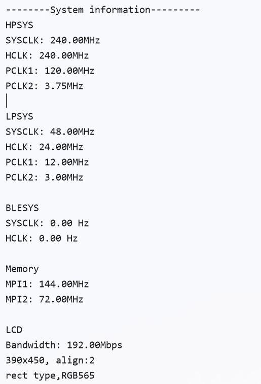

The main frequency has been reduced to 48MHz. How can this be modified?
483b3a7b-9e87-4a05-9274-f917e962fdbf

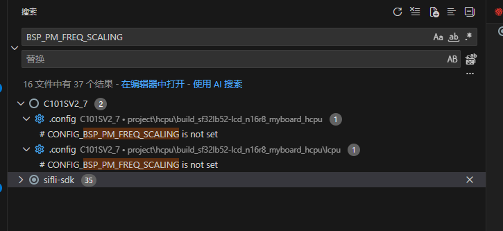

The compilation result shows that BSP_PM_FREQ_SCALING is undefined. However, sysinfo indicates that the CPU frequency has been reduced.
The macro cannot control the 52-chip; it’s set to downclock by default. In audio_server.c, when audio starts, it calls the following code to prevent downclocking and sleep:
