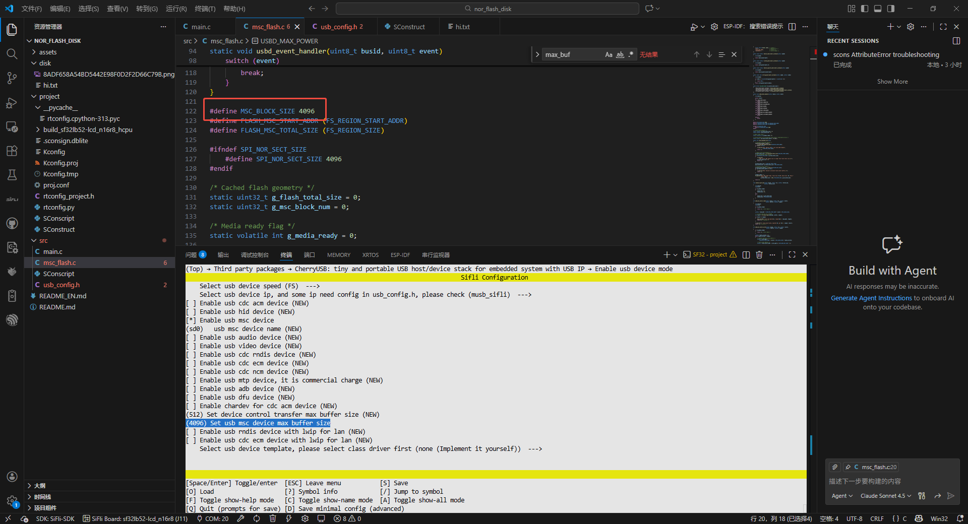

But the two accesses (USB and program) do not point to the same files.
However, I checked and the FLASH addresses are the same:
#define MSC_BLOCK_SIZE           512
#define FLASH_MSC_START_ADDR     (FS_REGION_START_ADDR)
#define FLASH_MSC_TOTAL_SIZE     (FS_REGION_SIZE)
#ifndef SPI_NOR_SECT_SIZE
    #define SPI_NOR_SECT_SIZE    4096
#endif

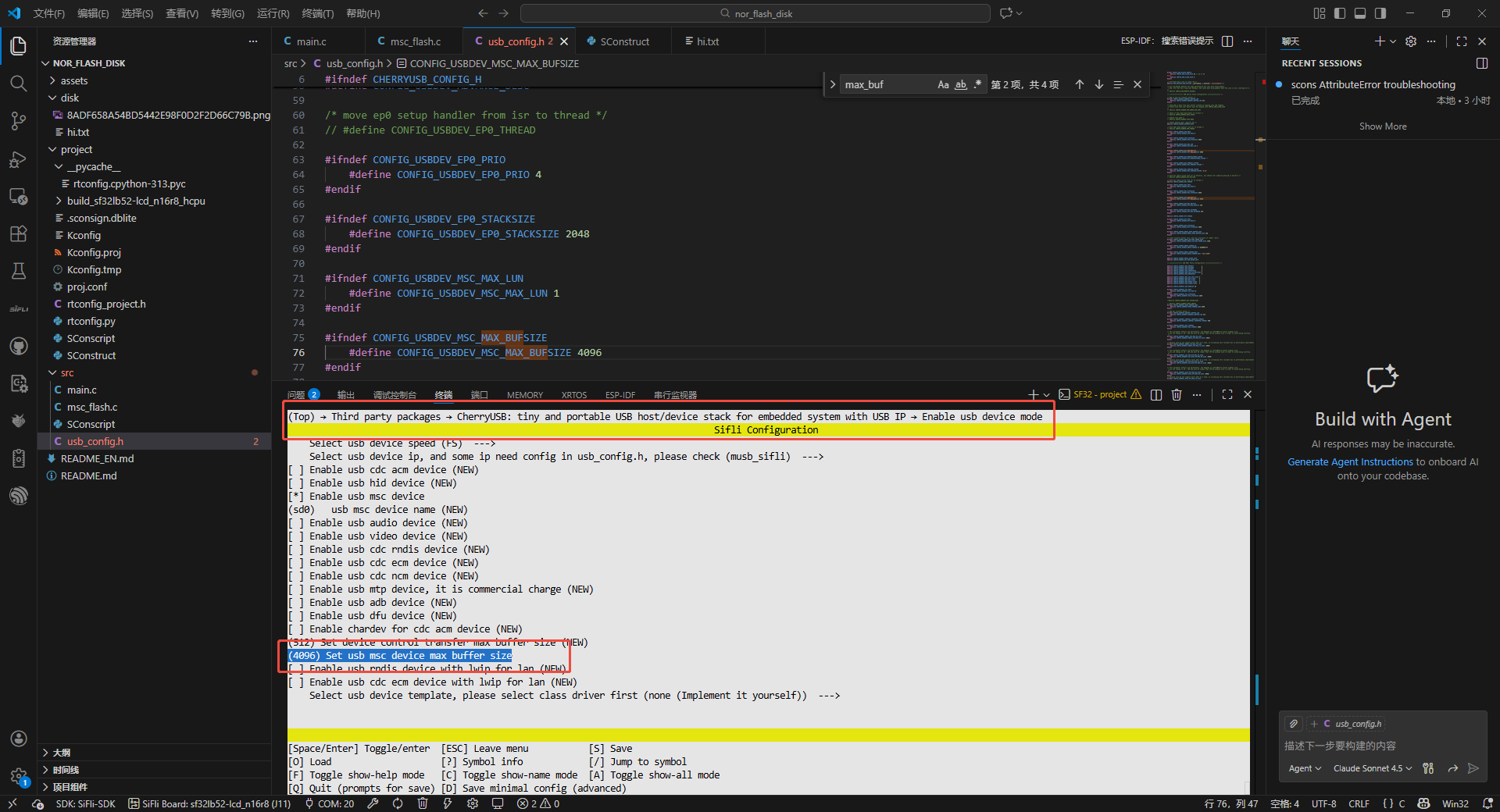

Change the configuration values in these two locations to 4096 so they match the physical sector size of the flash memory, allowing proper recognition.
