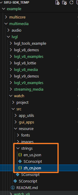

How to use multiple languages in SDK->watch?
How to use multiple languages in SDK → watch?
Is there a tutorial on how to switch between Chinese and English?
If you are using the open-source SDK, you’ll need to seek support from the SDK side. The implementation mechanism of Solution can be found here: 多语言支持 - SiFli Solution Documents 文档
The documentation will be updated soon with a comprehensive FAQ section.
Do you need to seek support from the SDK side? Is it also necessary to write an application on the BBS? Are there any other methods?
There’s no need to post again; we’ll handle it uniformly. The lvgl graphics library in the SDK supports multiple languages, but it’s not currently being utilized in the watch. We need to update the example code to incorporate these string resources. Updates will be shared here once available.
