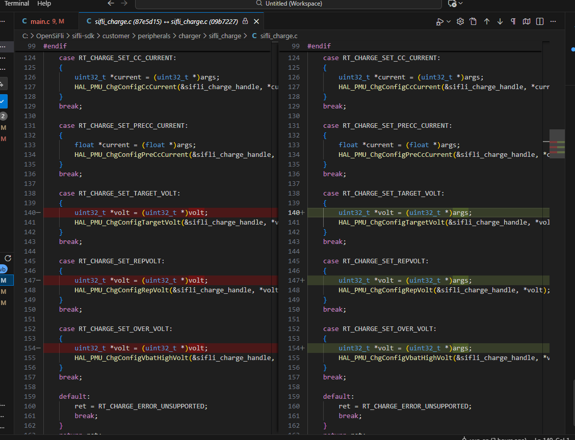

I have already fixed an issue in the SDK, as shown in the image below:

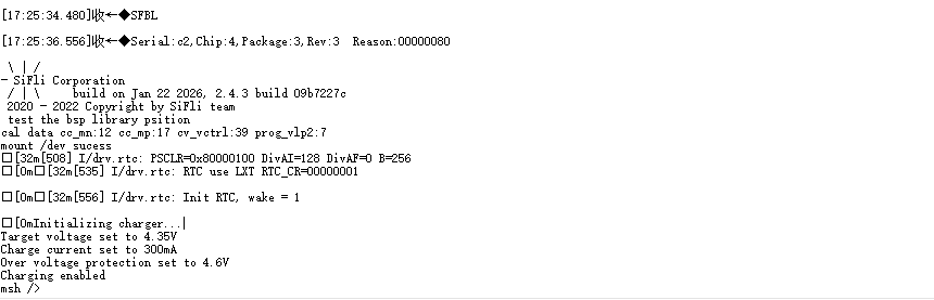

However, the charging module still does not work properly. What could be the problem? The log output is as follows:
