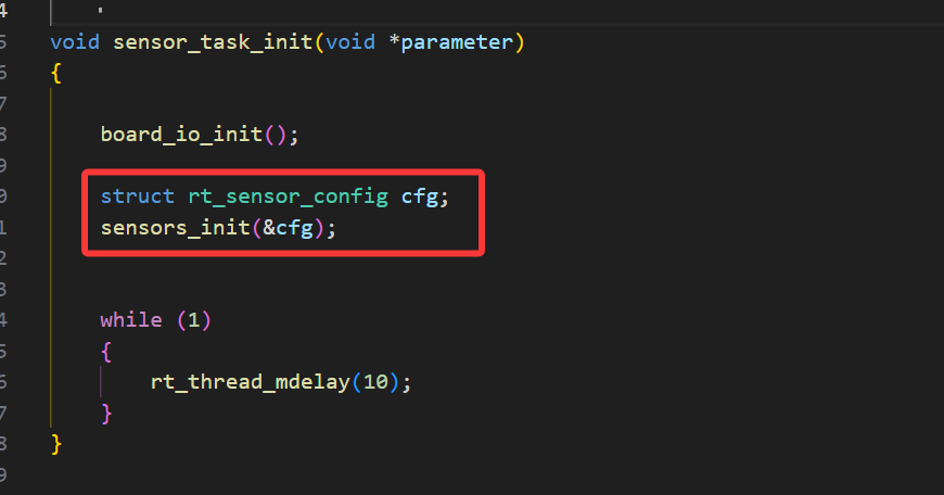

How to use I2C sensors with Xiaozhi on Huangshan Pi? I registered and tried to use the built-in lsm6dsl sensor in Xiaozhi, referring to the sensor example project under the SDK. After running it on Xiaozhi, I encountered the following error. How should I modify the code to make it work properly?
[21693] I/sensor motor: rt_sensor init success
[21700] I/sensor motor: rt_sensor init success
[21706] I/sensor motor: rt_sensor init success
[21713] E/drv.i2c motor: bus err:1, xfer:0/2, i2c_stat:20, i2c_errcode=21
[21724] E/drv.i2c motor: reset and send 9 clks
[21731] E/sensor.st.lsm6dsl motor: read id failed
[21737] E/sensor.st.lsm6dsl motor: _lsm6dsl init err code: -1

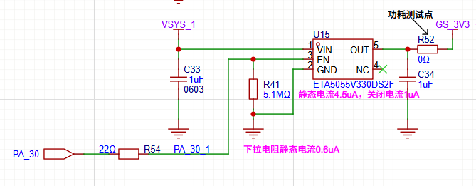

Test whether the GS_3V3 power supply is turned on:

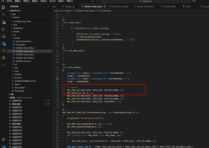

The PA30 has been mistakenly pulled low at this point in Xiao Zhi’s project. You need to enable it again here. Then check whether the power supply is normal. If there’s still no power, you may need to further check whether the upstream power source is turned on.

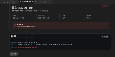

Hey expert, I’m getting an error in my VSCode code, specifically with the header file. How can I fix this? Also, when installing the plugin and importing an existing SDK, I encountered this issue:
