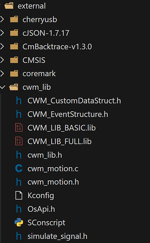

This is the latest build under main, but libraries cannot be found.
The library has been confirmed to exist.

The cwm library does not exist under release 2.4.4.

This is caused by a missing library file for the gcc version. We will submit a fix shortly; please wait for the upcoming update to the main branch.
The main branch has now been updated with the GCC version library. You can pull the latest repository and try building again.
