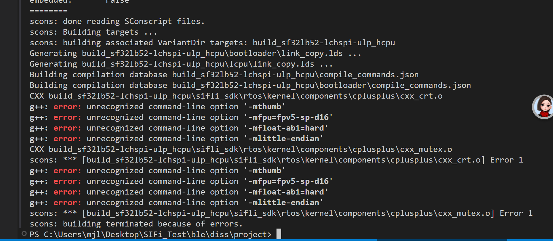

example/ble/diss compilation error
As shown in the figure
It shouldn’t be an issue with my environment, I’m using the VSCode plugin.

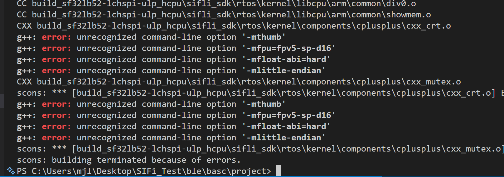

The same error occurs for ble/basc as well.
There seems to be an issue with the compilation command generation, calling the wrong g++. Try replacing the following file under sdk/tools/build:
