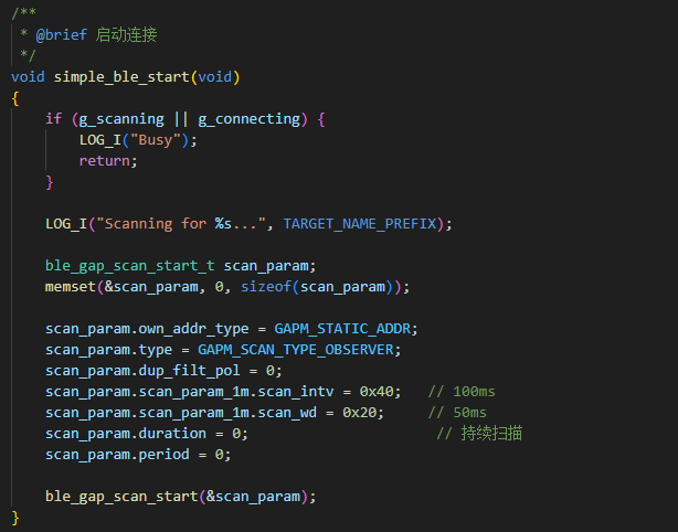

The project is too large to send. Currently, data is being sent via serial port, and then the function simple_ble_start(void) below is triggered.
Originally, the example code was designed for the device to act as a slave (peripheral) connected by a phone. The current idea is to add a new task so that the device can simultaneously act as both a slave (peripheral) and a master (central). As a master, it should be able to connect to other slave devices and communicate with them. The current issue is: after starting, the connection succeeds, but communication fails. The slave continuously sends data, but the master does not receive or print it.
