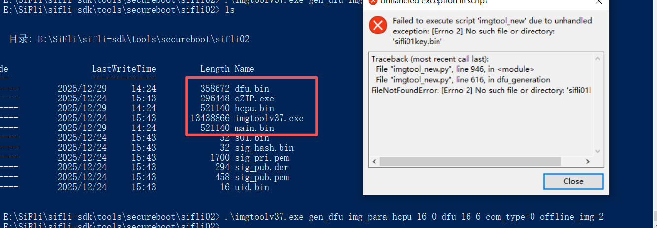

I followed the process outlined in OTA Upgrade Package Creation - Troubleshooting - SiFli BBS. I copied main.bin and dfu.bin into tools/secureboot, but it still reports an error.
- How can I generate my own key?
The main.bin needs to be renamed to hcpu.bin. Additionally, hcpu.bin, dfu.bin, ezip.exe, and imgtoolv37.exe all need to be placed in the sifli02 folder.

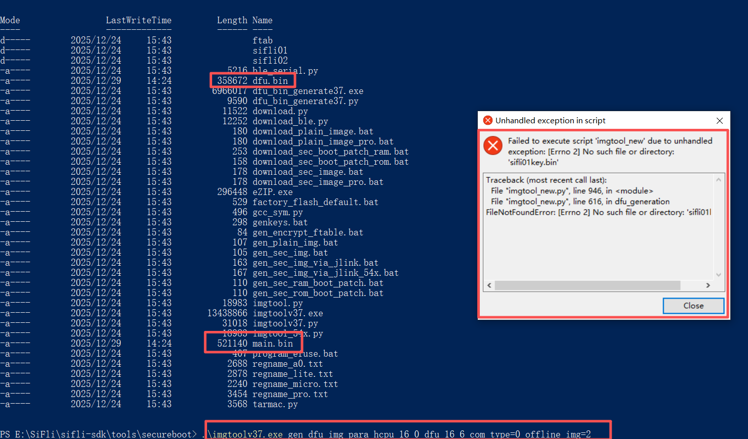

Copied it in, but still getting an error. My SDK is V2.4
Still getting an error, as shown in the figure above.
