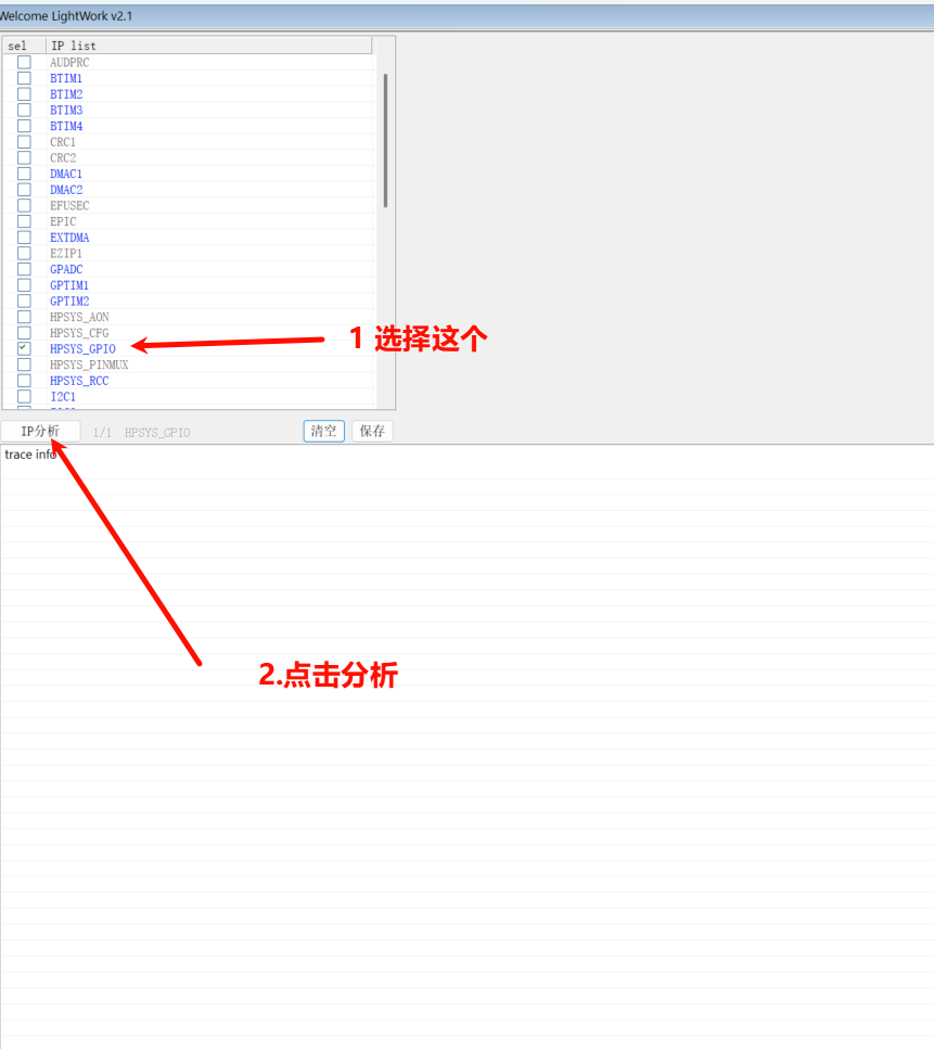

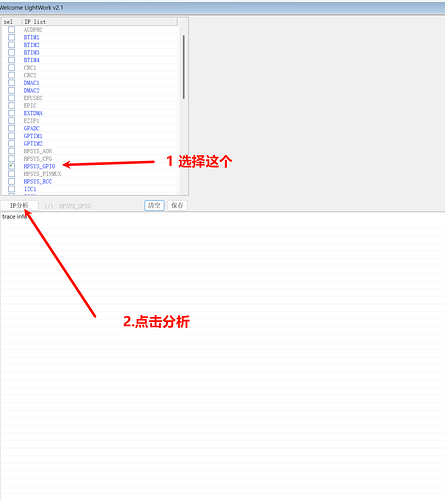

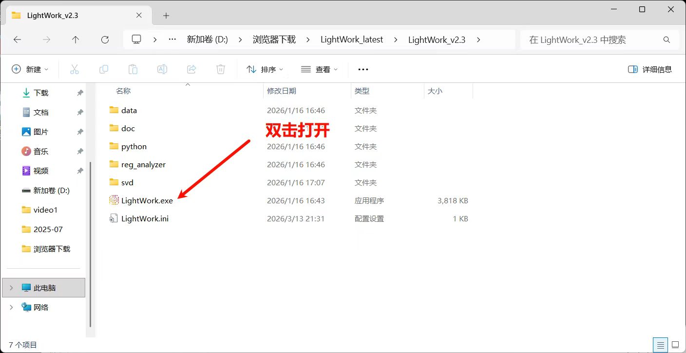

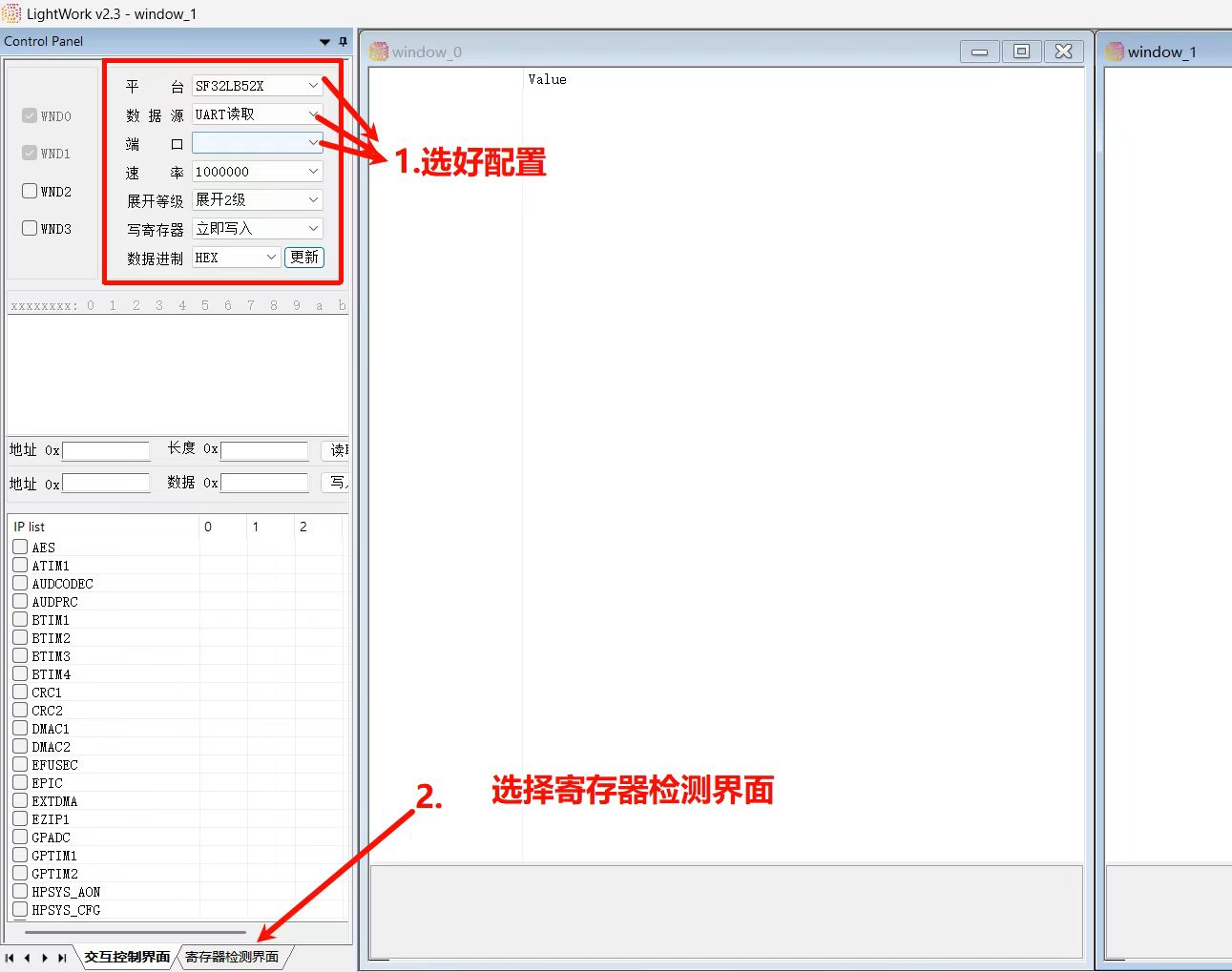

Additionally, here is one of our tools that can be used to check whether your IO configurations are reasonable. However, please note that this tool only performs a basic review of your IO setup and cannot detect all sources of leakage current. Hope it helps:
